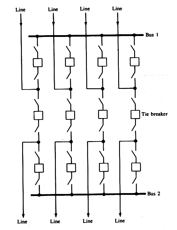

How many generators are "in parallel" that supply the public grid?
Lots, and often interconnected with something like this:
