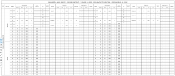

A Alwayslearningelec Senior Member Location NJ Occupation Estimator Feb 6, 2024 #1 I thought PDU's were only like these rack power strips. I came across a schedule like this and it's obviously and entirely different animal. Anyone seen a PDU like this schedule?
Z zbang Senior Member Location Roughly 5346 miles from Earls Court Feb 6, 2024 #2 A PDU can be anything that distributes power, including what look like a panel mounted in a pedestal. Those are often seen at the end of a row of racks/cabinets (such as https://datacsi.com/products/liebert-sts2-pdu-400-amp/).
