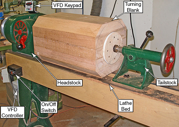

Rick Christopherson

VFD: For a woodworking lathe, my number-one recommendation without reservation is a VFD. Even if your lathe uses a reeves drive for speed control (infinitely variable) it still has a minimum speed at which it can reduce the motor speed.
A few years ago when I needed to turn a very massive table pedestal, I removed the RPC from my lathe and replaced it with a VFD so I could slow the lathe down further than the reeves drive would permit. For normal turning operations, I keep the VFD at 60 hertz, and use the reeves drive for speed control (this is the healthiest method for the non-VFD-rated motor). But, when I need to run the lathe at very low rpm, I set the reeves drive to its lowest speed (less load on the motor) and then use the VFD to drop the motor speed.
Most VFDs that are designed for 1-phase input are smaller than 3 hp, but you can still use larger VFDs on single-phase as long as you derate them to 66% of their full-load rating. That's because the input section of the VFD rectifies the AC signal into a DC bus, and it is the amps/phase through each diode bank that limits the available power. However, a 7.5 hp lathe is HUGE, and it is very unlikely that you could ever load that motor to 66% of its rating. So in this case, if you derate the lathe to never exceed 5 hp (which is still huge), then you won't need to derate the VFD (save $$$) and can use a 7.5 hp VFD that outputs only 5 hp.
I have a few self-help articles on my website for phase converters and the VFD is briefly mentioned in the Contruction Blog for a $15,000 dining room table (that's where the pictures below came from).
I chose to use a GS2 VFD for my 800 pound, 1 hp Oliver lathe because it had the features I wanted, but also because it had a remote keypad/display that I could mount on top of the reeves drive so I could monitor speed and amperage to the motor.
This is a picture of the turning blank that prompted me to install the VFD. It weighs somewhere in the ballpark of 60+ pounds and is so large that I had to manually round the corners with a planer before I could turn it on the lathe.

I'm surprised that VFD isn't mounted in a Nema 12 box, doesn't sawdust fill the VFD openings?
Any after pics of that big turning blank?:)
