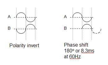

Smart $ said:I'd just like to note that this representation is inaccurate. I don't know of any commonly used split- or multi-phase generation system that does not have any output prior to the delay time. The delay or lag or shift is only the reference point in the cycle, but the waveform exists at t = 0.

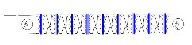

crossman said:So the diagram that was posted with the nine transformers and claiming that the final output would be lagging in time before the light came on is just not correct.
dbuckley said:Now if each transformer introduces 180 degrees of phase shift, or a delay of 8.333 milliseconds

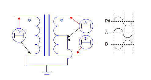

Here's an example I'll toss in for entertainment purposes. A bank of two 3? 208Y/120 transformers with a common N and reversed primaries. This system could power three 120/240 systems with performance basically indistinguishable from that of typical systems.winnie said:...In the three phase world, a delta-wye transformer produces a 30 degree phase difference on its output, without any sort of time delay elements...
