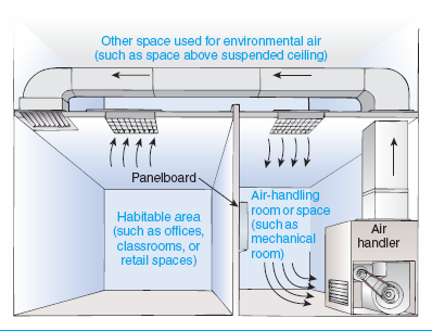

Thanks. What seems to confuse matters is the handbook. It shows a room that has a electrical panel and an air handler. This is what led to my questioning.
I think I see what you are saying.
Your room is like the room on the right in the drawing except that it has a water heater, washer and dryer in it, right? So, if you remove the w/h, washer and dryer it would be just like the room on the right?
I can see where this room might be considered as being primarily for air handling space since the air handler is located in the room. It's a good question and I'm not sure what the answer would be.:-?

Again I think chris nailed it earlier with the bolded section
(C) Other Space Used for Environmental Air. This section applies to space used for environmental air-handling purposes other than ducts and plenums as specified in 300.22(A) and (B). It does not include habitable rooms or areas of buildings, the prime purpose of which is not air handling.
FPN: The space over a hung ceiling used for environmental air-handling purposes is an example of the type of other space to which this section applies.
Exception: This section shall not apply to the joist or stud spaces of dwelling units where the wiring passes through such spaces perpendicular to the long dimension of such spaces.
I am not sure what the handbook is trying to illustrate, a panel board would be allowed in 'other airspace' unless it was plastic.
My gut says your over thinking it as any building with forced air heating / cooling is going to be used for air handling.
