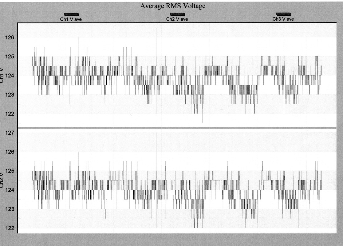

5 day recording by poco for 120/240 1ph resi.
poco tells me they run by ANSI C84.1 (i assume range A)
under C84.1 is it supposed to be 120 nominal, at least once? this chart shows ~124 nominal.
but i'll ask, does ANSI C84.1 just provide a min/max range, or does it also spec that nominal should be 120v with the allowance for fluctuation to min/max ?
this chart does not look to me to be complaint with C84.1. I rather sure it went above 127v at least once, but poco says "all looks ok".
what say you?

What is the definition of "nominal"?
The following is from https://www.merriam-webster.com/dictionary/nominal
See 3 b.
In other words the design criteria is for 120 V.
The recordings show a somewhat instantaneous set of values, actually short time average values. Looking at the charts the overall daily average is about 124 V. This is the output of a nominal 120 V supply. Very typical.
Nominal and average do not mean the same thing.
You need to look for some other criteria than nominal to determine if power company meets its obligations. Somewhere a definition of a short time average time period is needed.
Looks okay, perhaps something changes due to weather, wind, neigbors neutral, etc... What's the reason for the test?
Voltage dips & spikes (i suspect spike) are causing a APC UPS to trip on for short period. This happens 3-7x weekly.
The 127v seems a bit high though, that's the max under the ANSI spec.
I'll dig out my DATAQ 16kHz recorder to see what I can find, I don't think poco recorder is of any good type.

I don't know if UPSs trip on spikes, usually it is dips. I also don't trust power company recording, from experience, unless I really know something about their recorder.
I believe APC UPSs have data output that provides time information on transitions. Requires a serial port data collector.
With an old model TED 1000 I can record line voltage with 1 second, and 0.1 V resolution. See my plot PE1 at http://beta-a2.com/energy.html . Also see plots P29 and P30 at http://beta-a2.com/EE-photos.html . These last plots are at the end of a long branch circuit, not at the main panel. The other plots were at the main panel.

On the surface the power company plot does not show a problem, but their averaging time per point may be too long.
You will need to run your own tests.
My comment on the APC data output was that it provides timing information on when events occur which would make it easier to look for a glimpse of what is happening at very isolated times in the power company plot.
Yes it looks ok. Looks like they have about a 124 volt setpoint and reasonable bandwidth and minimal excursions beyond 126 volts. Probably typical for loads close to a substation/regulator. If this were further out I would have concerns.
It is 120v nominal, 124v average.
120v with normal being to the min/max. Brief excursions outside min/max are expected to be brought back within min/max. It does not say voltages will never go beyond min/max.
looks compliant to me.

I wouldn't be all to worried with a stable transmission system and tap changers that tap down faster as the voltage increases. Yes 123 would be better, but it increases the odds of having to put up mid line or end line regulators.
I wouldn't be all to worried with a stable transmission system. Yes 123 would be better, but it increases the odds of having to put up mid line or end line regulators.
Between 124 and 125 would do. Adding regulators as needed is what a utility does. Goes with the job.
