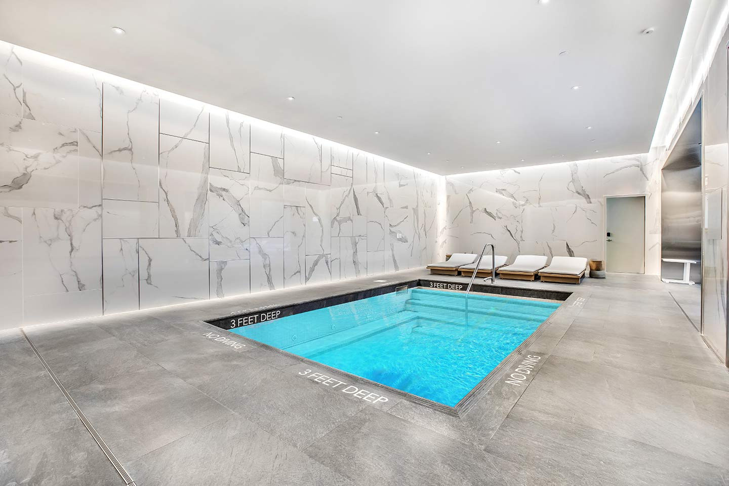

This one is just funny........Within 5' along one entire edge of this pool is a a trench drain. The grate is metal and in 1' sections.
I am pretty certain I will have to bond each piece. But my question is how? Does it have to be a listed assembly or am I allowed to come up with my own method? The place is to either through bolt each piece or drill and tap. I'd have a continuous #8 running the length of the drain.
