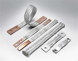

Do you have a picture or diagram of what a removable jumper looks like?
Here is one example:
But you could make your own with approved lugs and solid wire. You wouldn't need to remove the mounting screws, just loosen the lug.
