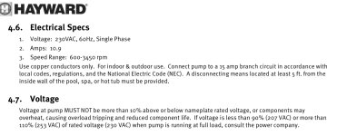

So on a personal note I'm getting inground pool and yes will have licensed electrical do the work. Curious about something.
I'm getting a 2.7HP variable speed pump single phase. I will also need a GFI on the equipment pad. Can they both share a circuit?
The pool control panel will likely have breaker spaces you can use to power other branch circuits. Would you really want a general use circuit powered off of one leg of the 2 pole GFCI breaker for the pump?
This may be another item where the horse power is "Sears" horsepower and not real HP. The nameplate amps for the Jandy pump mystic Pools linked is 16A at 120V. That seems like a real 1.25 to 1.5HP to me. But this is still too big to put a convenience receptacle on the same circuit as 210.23(B)(2) limits fastened-in-place equipment to 50% of the circuit rating when you mix general receptacles with fixed equipment.

The ratings on the VS pumps are THP (Total Horsepower). As per the OP, 2.7 pump to be used is closer to a single speed 3 HP.

This is the pump.
