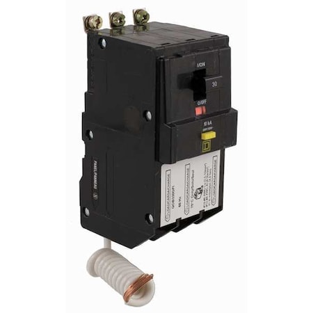

Try doing research on your own for 3-phase GFI circuit breakers. The only one that comes up is made by Square D. It’s a bolt-on breaker and costs about $1800. Availability is questionable.
Where are you getting the $1,800 price tag from? I have no idea what the current availability is but there is no way a wholesale SquareD distributor would charge that much.
Even online retailers are much less than that.
Here is one example.
The first time I researched it the price came up as $1800. The voltage is 240, 3-phase. In addition we would have to change out two entire panels just to accommodate these breakers. I’ll post a photo of the product that was installed when I can get to my computer.
What type of system is that? Class A GFCIs are only for systems with a maximum voltage to ground of 150 volts. An ungrounded 240 volt delta system would have a voltage to ground of 240 volts per the definition and a 4 wire high leg delta would have a voltage to ground of 208 volts.
The only thing you could use on either of those systems would be a special purpose GFCI also known as a Class C GFCI, but those are even more expensive. The use of SPGFCI is provided for in Article 680 in the 2023 code, but I think they are even more costly than what you have been looking at.
