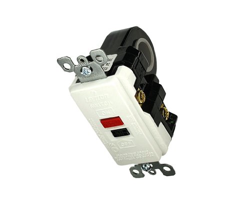

Why not use one of these.....?
~RJ~
kwired
Electron manager
NE Nebraska
I went to the Leviton website, but I cannot find a blank face 250 volt GFCI. Where did you find that?
Lowes and Home Desperate do have the 125 V GFCI blank face on the shelf around here. Popular for bathroom spa type tubs.
Look at the one pictured carefully - is not a typical device box GFCI instead it has a CT loop on the back side, you should be able to place any voltage conductors through there, as long as all incoming and return current passes through the CT, the output will be satisfied.

Size of the CT opening could be a limiting factor for OP - he likely needs about 8 AWG conductors the way it sounds on his main supply anyway.
