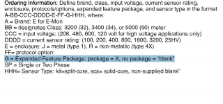

I will replace a 750 kVA 208/120v pad mounted transformer with 1500kVA 208/120v pad mounted transformer due to change in load requirement, the existing demand power meter has a split core current sensor rated 3200A connected to the secondary bus of the existing transformer , do i need to upgrade also the metering system based on the 1500kVA transformer? or is it ok to re use the existing? Thank you in advance for the answers.
