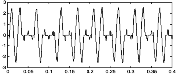

However, more than likely, the cause is related to the way the printer draws power causing a few volts of voltage drops at the panel. Few volts, but very rapidly. You might get rid of flicker in one area if you re-locate the breaker, but simply move the flicker or other problems elsewhere. It all has to do with energy conservation features of laser printers so that heaters are not remaining on like a pilot light in an old furnace yet be able to start printing relatively briskly without delay.
It works like plugging a 20A load into an outlet and very rapidly cycling it. (ignore the vertical scale... the pulses of real printers are often 15-20A). Even if the ballast is rated 120 to 277v, that means it will operate at the same power with gradual input voltage change. Not that output won't flicker at very abrupt notches. The sudden notching will also cause some UPS to predict as power disturbance and transfer to battery momentarily. If this happens with regularity (with every printer use) it will quickly wear out the battery.
Transient response characteristics isn't part of the specs, so the influence on the output light depends on each ballast's design.
