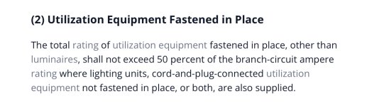

Where in the code does it permit a cord and plug connected microwave oven to be protected by the same 240v 20-amp breaker protecting the oven?
The oven installation is a replacement; the microwave is not. The original installation from 20 years ago had a two pole 30-amp breaker protecting both, as well as a warming drawer below the oven.
I was adamant to have an individual 20-amp circuit for the microwave and ran a new one. But was I wrong in claiming it to be code? After all it is not a microwave hood.
The oven and microwave and warming drawer are stacked in a cabinet, with the warming drawer below the oven. The warming drawer was abandoned.

Last 30yrs fixed range-hood microwave not allowed to exceed 50% of branch circuit rating 210.23(A)(2), if not a dedicated circuit.
New cord & plug range-hood microwave also requires dedicated circuit unless hardwired 422.16(B)(4)(3)

It basically only limits the connected load of the circuit also serves lights or equipment not fastened in place.

I'm not seeing any requirement for each appliance to be less than 80% of the circuit rating if they are both fastened in place.
But the load being under 20A would be a bit tight if the microwave is 120V cord-and-plug connected and the oven is 240V. I guess you could have a 10A microwave (1200VA nameplate) and a 10A oven (2400VA nameplate).
The oven is fastened in place, the microwave is cord connected.
Specifying cord connected does not specify whether it is fastened in place or not. Is the microwave just sitting on a shelf, so you can unplug it and remove it? Or does it have a "built-in" trim kit that you'd have to dismantle in order to move it? I'd consider the latter to be fastened in place, depending on the details.

As the microwave is 120V, that's too much for a single 20A circuit. 720/120 = 6A, and 3600/240V = 15A, the sum is 21A.

After re-reading it, you are correct.
The 80% only applies to “not fastened in place.” I’m not sure I understand the logic behind that.
