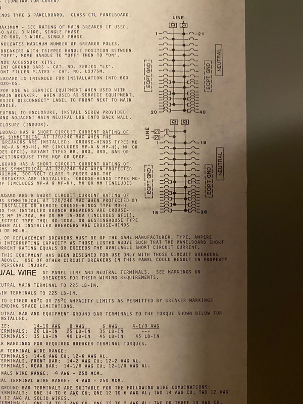

I am looking to install a dedicated breaker (20 amp) for a mini-split AC. My panel is full but I was thinking to install a tandem breaker and free up one slot but I wanted to make sure that me adding another breaker with be within the code.
1) My main breaker is 100 amp, however, the panel diagram says 200 amp panel - how do I read this? is my max 200 amp if I replace the breaker from 100 amp to 200 amp?
2) I have 32 breakers overall (4 of which are the double slot breakers for 220v)
3) here is the diagram with the tandem breakers allowance and overall I am below 40 breakers so I should be all set I believe but wanted to confirm. My line comes in from the top but the breaker is in the top left corner
