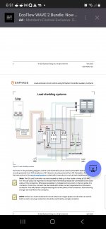

Customer has a battery back up system with a smart controller. The smart controller locks out certain non critical loads in the event of a power outage, via control wire and relay. The voltage from this control wire is 24 volts.
The customer would like 2 heat pumps used for his pool to be locked out when the power goes out. The heat pumps are controlled through a control wire that comes from a 5 volt control board to the heat pump.
Is it possible to interrupt heat pump control wire with a relay?
