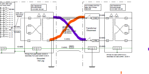

H1 and H2 are going across a conduit maybe 300 yards or more. If H1 and H2 of the Step up / Stepdown got reversed because we didn't tone them out, would the physics of the windings change and the transformers behave incorrectly?

No it would not matter. What's the point in stepping up the voltage then reducing it? Are you trying to adjust for voltage drop? You must consider the transformer losses. If you need a voltage drop calculation I can do that for you.
Does not matter. How did someone manage to swap a black wire with a white one?
Just curious why you are grounding one of the 600 V legs.
Must be a heck of a long run to need #6 wire for 8 amps.
It would not matter for typical 600V class transformers.
It absolutely would be a problem for higher voltage 'single bushing' transformers. Typical distribution transformers are designed with 1 high voltage terminal and one _grounded_ terminal on the primary. The transformer magnetics wouldn't care about the polarity swap, but the insulation system would have something to say as the magic smoke came out....
