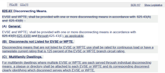

In TerraView, is the "Second Correlating Revision" link the "final version"?
Is there a clean way to get the final version with all the markup stripped out, if not?
Question:
I'm uncertain on that.
The "Hide Legislative" is supposed to do that, but it appears to be broken for 625.43. It does work for 625.2, but goes off the rails sometime after that.
If you click on the SCR version, and choose "hide deleted", you get the text with the new words underlined, but the deleted portions gone, so there's that.
Cheers, Wayne
Cheers, Wayne
Thanks.
Note one can, ahem, install a copy & paste override extension to a browser. TerrisView helpfully blocks the text copy operation in a browser.
The final version will only exist after the standards council approves the 2026 code.
Most of what is in the second draft report will remain as is, however there is a possibility of a Notice of Intent to Make a Motion for any change that was made. If the NITMAM is approved, it will become a Certified Amending Motion and will be debated at the technical sessions of the NFPA meeting in June. I think maybe (A), (B) and (C) will be ok, but pretty sure there will be NITMANs for (E)
The purpose of my question was in fact, finding a way to copy the 2nd draft text as on the table now,
for purpose of preparing and drafting a NITMAM for section (E). The NFPA website blocks copy & paste.
Open the SCR and click on "committee" for a clean copy of what the 2026 will look like. You can't copy and past from the actual second draft report, but if you open the PC, SCR and things like that, you can copy and past from those documents.
