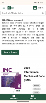

How are they handling makeup air?
Many times it's done through the HVAC return air, but sometimes they don't want air pulling through the whole house.
Last year I did MUA with inline heater, and it was pretty involved
I would add that these "pro" type hoods almost always are of pretty high CFM and triggering building codes that require make up air. This can get complicated and not something you want to do after rough.
Anything over 400 CFM requires makeup air.

Mechanical code.
This is also a standard boilerplate on architectural drawings even if no building code is specified
