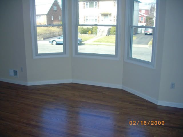

You need to measure the actual wall space, not as the crow flies... Looks like another receptacle is required. The electrician and inspector dropped the ball on that one.
All parts of the wall in the alcove were within 6' (just barely) of the receptacles.
Sorry, I didn't notice that in the OP.
No additional receptacles required.
One below the center window might be nice for holiday lighting...but there is no window sill for the lights anyway.
...then you are "just barely" in compliance.
"Just barely" is not on my tape measure :D
I've worked with a lot of people who's tapes that have things like hairs, tad bits. I've also encountered inspectors with different size inches. The thing that's odd is it usually seemed like "their tape" had an autoadjust that compensates toward noncompliance.
It "looks" compliant to me. I really love the quote,"Just barely in compliance."
How about, "You are just barely in compliance with the bare minium
safety requirements of the NEC.":D

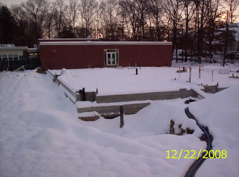

How come the grass is green and there is no snow on the ground?
Feel better now?
