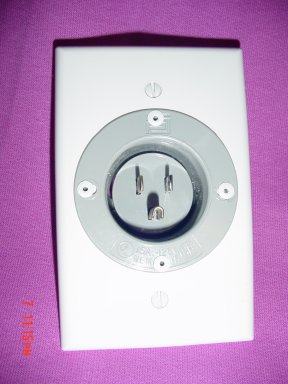

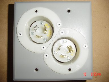

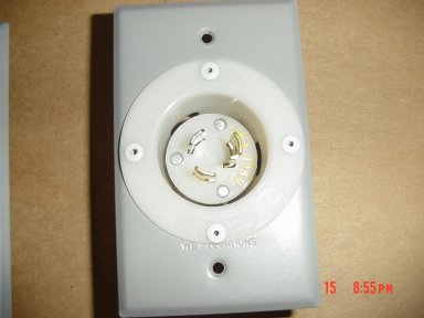

It sounds like you need a wall-plate-mounted power inlet. It just so happens that I recently put together a few for an audio/video system.
This one for residential job:
These for a commercial job:
