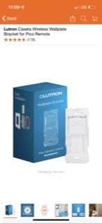

The orange box has them, probably the blue box too.View attachment 2559529
Oh that isn't what I pictured when you said "There is even a kit that makes the remotes look like a regular decora switch."
That just makes the remote look like a wall mounted Pico. Not a decora switch.
This is what I pictured.

Yes, a decora dimmer, not a regular decora switch.
Frankly, the Pico remotes do match the Caséta dimmers anklet exactly so that's good. Although I don't particularly care for the look of the Caséta, it just looks busy. I tend to go for the Lutron Diva or Maestro dimmers in a home that has Decora switches (obviously no "smart" features with those options)
Caséta with a Pico is a good choice for the OP's situation, although I echo their concern that the walls ARE OPEN and an inspector might feel they NEED to wire in a 3wy.
