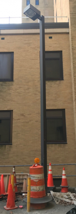

Being asked to remove this light pole which is about 25' and place it on ground about 50' away.
What piece of equipment would be best for this and how would one secure it to that equipment?

The obvious answer is a small crane and whatever the crane operator wants to use (usually a nylon sling). Might need a bucket truck to attach the sling. If there's already a crane on-site, just ask them do do it.
So just a bucket truck couldn't remove and reinstall it?
