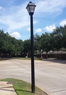

I noticed that some light poles on commercial parking light have concrete base that elevates them from floor like this:
However, residential light poles do not have them like this:
I heard pole base foundation are installed so water does not get into pole and for safety reason. How can residential poles avoid such water getting into them without pole base foundation? Should residential pole also have base foundation?

Post #1 I don’t mean residential as in driveway. I mean residential street light one installs for neighborhood. We have new townhome community being built and this is commercial/residential in that light poles are for interior community not for ones driveway or home post #1.
