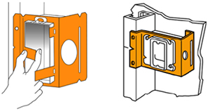

Jim try these instead of messing around with 2x4s
Cheap fast and easy.

Mostly we use plastic bracket boxes.the 4 gangs come with something like that but kinda flimsy.
We just pick up small blocks of 2x4 and screw gun puts them on in a few seconds
Re: Romex in metal studs
Bob those work great with 4 sqs. but for the most part pvc bracket boxes are used and when there are 2 gangs and up you have to brace them to ease trim out.I like using pieces of metal studs to do this less weight than lumber and readily found.Nobody mentioned securing nm within distances from a box and running down the studs.There are stand offs that have one hole in the end to secure them and a clip type ring on the ends that holds the nm.Funny part is they are not ul listed but state that they conform to 300 4 d.
I do not know of a product for plastic boxes, the product I showed will work for metal 4" sqs or metal switch boxes.
