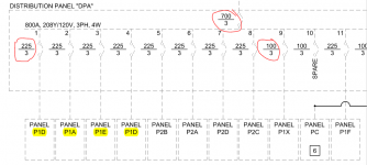

E elenTemp Member Location San Diego Occupation EE Aug 10, 2023 #1 Hi, what do 225/3 , 700/3 , and 100/3 mean? Thank you, Master Electrician Elen Temp?
K Krusscher Senior Member Location Washington State Occupation Electrician Aug 10, 2023 #2 3 pole breakers with there rating
infinity Moderator Staff member Location New Jersey Occupation Journeyman Electrician (retired) Aug 10, 2023 #3 I agree, if you look at Table 240.6(A) you'll see that they are all standard OCPD sizes.
Jraef Moderator, OTD Staff member Location San Francisco Bay Area, CA, USA Occupation Electrical Engineer Aug 10, 2023 #4 Amps and poles; "700/3" = 700A 3 pole.
