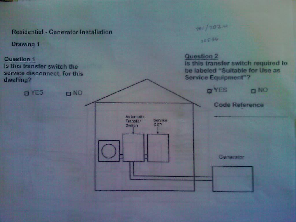

An inspector friend asked me a question over the weekend about an NEC reference for Question 2 on the following....
The only references I could come up with was 701/702.4, 230.66, and Art 100 definition of SE Equipment. Any other NEC points I am missing?
