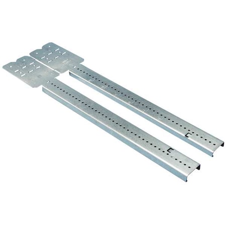

You can also use a bracket behind the 1900 box if you aren't concerned what it looks like within the cabinet. A Caddy TSGB cut down to 4" can be screwed in from the cabinet inside to hold the box in place.
Thank you, had no idea these existed!
