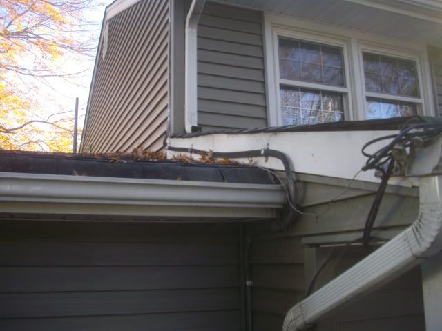

SEC Clearance to roof
Note that many of the clearances which cause concern such as 230.24 are for service drop conductors and not the SE cable attached to the drop.
And some here don't like RGS inside the wall for a service.:D
I just never gonna get used to seeing SEC on the side of a house. It's just sooo DIY looking. Loco POCO doesn't allow it and I grew up seeing only galvanized conduit and PVC.
I agree the service cable can be run close to the other roof but I cannot tell about the rest of the installation.
Where doe the service drop come from? Do you know it if it crosses the lower roof with proper clearances?
Install (based on the panel) is ca. 1975 - though SEC may be newer(?).
The home is set elevated significantly down from the street - so the drop is very high and comes down towards the service mast at the upper roof level.
From the picture, I agree that this is the only problem.
I agree. I don't like it, but it seems compliant (from what I can see). I'd like to see pictures of the drop and the meter box (just curious).
What's the light gray wire from the cable/telephone cables to the roof? I hope that it's not some sort of bonding jumper...
