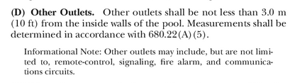

Nothing really clear about art 680.22 when it comes to a self contained hot tub near the edge of an inground pool. AHJ cited 680.22(D) which would be 10’. He said the equipment in the hot tub, motors, controller etc. But when I did some more research examples given were fire alarms, communications and low volt stuff. Didn’t do or sell the job yet just want some insight.

He sounds confused. 680.22(D) relates to "Other Outlets": "Other outlets shall be not less than 3.0 m (10 ft) from the inside walls of the pool. Measurements shall be determined in accordance with 680.22(A)(5)."

ETA: brain fart. I was confusing outlets with receptacles. He might be saying the equipment within the tub is considered "outlets" and is within the 10 ft limit.
680.22D in 2017 nec has a info note. A self-contained manufactured UL listed spa does not fit that info note IMHO.

The hot tub circuit does by definition have an "outlet". Exactly where that outlet is located is something that can be debated in no less then 300 posts here;)
"but are not limited to" leaves the door wide open though.
I disagree.
A outlet is where the end user takes power from, like adding a jbox to where a ckt terminates and then a microwave or receptacle hooks to that ckt/outlet.
In a self-contained manufactured spa, you the end user are not taking power from where the provided ckt ends, you are hooking the ends of the ckt into a spa termination point (box or cover of some sort).
In other words, you are not providing an "outlet" as defined by NEC definitions. You are only bringing the end of a ckt to the device/appliance/machine in hardwired fashion w/o using wire nuts (wire nuts are not typically found inside spas or dryers, as example).

I agree with you. Although i dont agree with the NEC on lots of verbiage, this seems to be another. 680.22D is a tad too vague IMHO.
If it's really an issue for the AHJ then just install a whip that can reach a jbox ("outlet") that is more than 10ft away. That is very silly as a workaround for the AHJ to say "ok" because the wires in the tub still terminate at exact same location, etc.

Great debate and insights. This inspector has left and the job was completed and passed I did discuss the new inspector which actually worked for a company that did lots of pool work prior to becoming inspector and he didn't see it the same way as the last inspector
