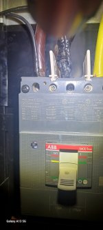

Thanks for all your input, lastly how can I know is the breaker is series rating?is there some way to know to identify it at first look? This is the breaker that I replaced because they say is series rating

First, in general, series rating or fully rated (the two options) are generally applies to entire distribution systems when first installed. As Augie said, you would need to do some of your own research and understand the concepts of series and full rating before any of us go to deep here, because it is too complex to explain in a few paragraphs. A couple things that any qualified electrician should know (and MANY don't) when doing service and repair work are: Look in a panel before installing a breaker. Makes sure any new breaker you put in has a AIC rating that is equal to are greater than the lowest AIC breaker in the panel. If you are installing a new breaker downstream from an existing panel it needs to be the same brand as the upstream panel and with an equal or higher AIC rating. If it is a different brand, you generally NEED to have a study done to determine short circuit ratings.
The breaker is likely in a fault current environment that exceeds the ratings listed on the breaker. I highlighted the 480V, 25kA rating. In order to series-rate that breaker there is a fuse or breaker that is in series with that breaker that gives it a higher rating than 25kA.
There will be a series-rating chart that lists that breaker with some other device.
You can get some clues from the breaker itself, but need more information to determine if a series rating is being used. Do you have a picture of the new breaker you put in?
If you look at the upper left of your picture, you will see a table that says 'Interrupting Rating'. This tells you the maximum short circuit current that the breaker is capable of interrupting. If you know the available short circuit current at the panel where the breaker was installed, you compare the interrupting rating to that number. You can't figure out the available short circuit current from the breaker itself; it is a characteristic of the electrical system installed. You compare the two numbers. If the available short circuit current is less than the interrupting rating, then the breaker is 'fully rated' for the application.
Now let's say that the available short circuit current is greater than the interrupting rating: then you need to investigate further. You need to check the upstream breaker or fuse, and look at the data sheet for the breaker. If the datasheet says that the breaker you have plus the upstream breaker you have has been tested for your available short circuit current, even though it is greater than the interrupting rating, then you have a 'series rating' situation. Note that the breaker is not a 'series rating', rather all breakers have interrupting ratings, and some of those interrupting ratings are 'series ratings'
Finally if the available short circuit current is greater than the interrupting rating and greater than what the datasheet allows, you have a mis-applied breaker that is not suitable for the application.

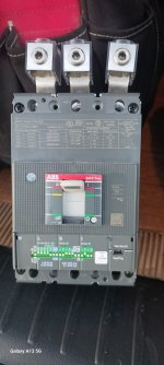

This is a photo of the replacement circuit breaker. I see at 480V the AIC show 35000Amp, this is the cause for change the former breaker?

Series ratings involve two breakers, one upstream and one downstream, as well as the available fault current the downstream breakers.
There is not much that can be said about a single piece of data.
Series ratings are found in tables not on breaker labels. Either go to the breaker manufacturer's tables on the internet or look for a label in the downstream panel.
You changed from a breaker with a 25,000 Amp rating to a 35,000 Amp rating. So if the available fault current is more than 25K and less than 35K, that means you now have a fully rated breaker.
Another possibility is that the fault current is even higher than 35K, and you still have a series rating, but now have a 'correct' one. As @jim dungar says, we can't really tell without more information. But you did up the interrupting rating quite a bit, so that is a strong clue.
Separate issue: In the picture it sure looks like the center conductor is severely heat damaged. That probably needs some looking into.
