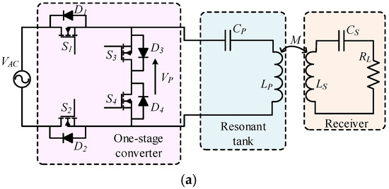

Both series and parallel resonant circuits can be used in wireless charging.
Below is a simple example of a wireless charging circuit with a series resonant "tank" inductively coupled to a series resonant load.
