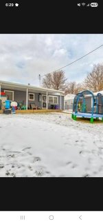

Hello, does the 8'6" clearance apply to a service that's going over a covered patio? Not sure what I should do in the below picture. It's probably close to 10ft in from the edge of the patio cover.
Thanks
See 230.24.
There are exceptions 2 & 3 for certain sloped roofs. I can't tell the rise / run from the photo.
Yes, I changed a service on a house that was similar and had to move it. They had a porch on the house that was obviously added after the original service was installed
But why did you have to move it rather than making the mast high enough so its 8.5ft above the awning?
Yeah. if you raise the mast high enough you can do it.. I my case it was SE cable around the house run under the porch roof and down to the meter. Illegal after they added the porch.
