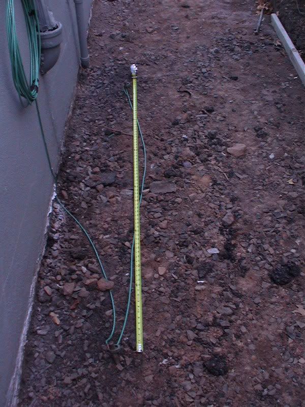

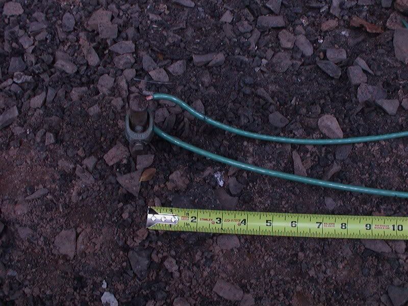

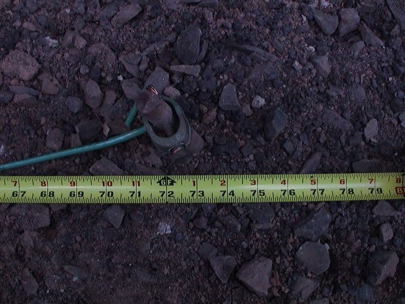

I thought that the GEC had to be continuous to both ground rods?
The drawing shows two clamps/wires.
Was I mis informed?
Was I mis informed?
220/221
Has to be continous to the first rod, a seperate clamp is allowable to connect the supplemental rod.
Ron
Was I mis informed?
You were misinformed however many EC still believe it needs to be continuous. I still install the GEC continuous to both rods. It's one clamp less and not hard to do.
