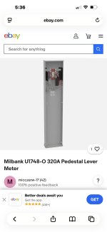

Normally it is a 320 amp meter base, and is a bolt in meter, not a standard plug in meter. If it is a bolt in meter, the Tesla collar will not physically work. Someone may have used a 200 amp service to feed two 200 amp panels. Does the meter base look unusually large for the meter? Then it’s probably a 320 amp meter.
I would say that pedestal is only rated for 200 amps, don’t have much for electrical inspections there? If they passed that, you are not going to have any problems with the Tesla collar! LOL!
You should check with the utility. They could have used a CL200 meter in a 320 cabinet. It is the same socket.
