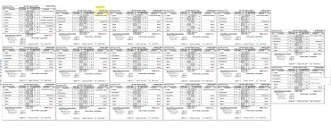

A Alwayslearningelec Senior Member Location NJ Occupation Estimator Today at 10:14 AM #1 So have 17 trailers with the below panels. THey are all right next to each other. So if each panel is about ~80A calculated load would I need my temp service to be 17x80A....~1360A? I'm thinking not and it could be less. Attachments Screenshot 2026-04-01 101331.jpg 1.1 MB · Views: 6
david luchini Moderator Staff member Location Connecticut Occupation Engineer Today at 10:26 AM #2 You could apply the receptacle demand factor.
A Alwayslearningelec Senior Member Location NJ Occupation Estimator Today at 11:25 AM #3 david luchini said: You could apply the receptacle demand factor. Click to expand... ???
JoeStillman Senior Member Location West Chester, PA Occupation Electrical PE Today at 11:33 AM #4 Alwayslearningelec said: ??? Click to expand... 220.44
