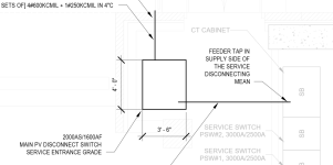

It would be conductors not bus. If there are no holes in the existing bus then a piece of bus is typically fabricated to allow for the connection of the conductors unless the bus can be drilled.

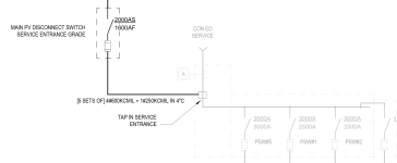

The bus is existing in the service box. From the switch you're connecting the 5 sets of 600's which are conductors to the existing service bus.

If there are no existing provisions for adding conductors (like in the photo) and the bus cannot be drilled then the bus would need to be modified with a new section added for the additional 5 sets of conductors. You would need a switchboard company to come in a measure the existing bus and fabricate the new bus section. After you run the conduit and pull in the conductors you could schedule a shutdown to add the bus section and tie in the 5 sets of conductors.

How frequent are problems with the listing worshipers in regards to this? Where modification is necessary, do these switchboard companies provide a UL field evaluation? Or do inspectors not really consider the ConEd tap box to be under the nec?

I'm assuming that a qualified switchboard company has the blessing of the AHJ to make modifications that are inline with the listing of the equipment. I've never seen anyone question it once it got past plan review nor had I ever seen a NRTL person look at the final product. These guys would come in and take their measurements, fabricate, and ship to the field. Sparkys would do the installation. It is possible that a behind the scenes evaluation took place but I doubt it.

I am curious about this as an alternative to getting a UL field eval. Are people finding using a switchboard company (assuming it's acceptable to the AHJ) cheaper than getting a UL field evaluation? Say i need to make some modification to a switchboard. Technically, a "switchboard company" has no greater ability to modify/certify a piece of equipment then an electrician does. Of course it just comes down to what the ahj will accept
