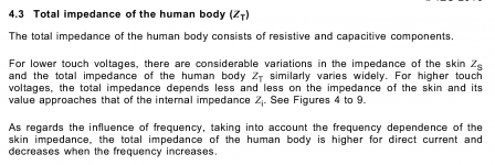

IEC-60479-1 is an excellent document. I think the full version can be found via Google.

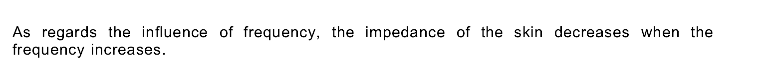

In short, as frequency increases, the amount of current that can pass through skin also increases (capcitive component). However, this diminishes when skin breaks down.
Total body impedance:
