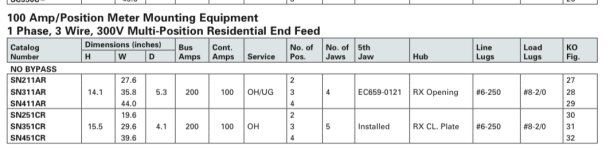

siemens sn351cr stackabilty
darekelec
nyc
how many of these can I stack together?
what's the bus bar rating?
I tried searching online without luck.
thank you
  • US2_SN351CR_datasheet_en.pdf
I talked with Siemens Engeneer and its a 100 amp meter can with 200 amp busbar. One can get them in 1-4 already stacked configuration. I thought they are assembled in the field.
