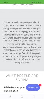

Simple Switch for load sharing
tom baker
Bremerton, Washington
Master Electrician
This device allows load sharing for an EV or dryer, range.
I checked and it’s UL listed.
It was in a Facebook ad I saw.
Perhaps a solution for panels with limited ckts or ampacit
And let’s not get off into ev vs gas.

I've heard about things like this being common in Canada as a way to add electric heat in areas with 60 and 100 amp services. I'm all for making it simple but I want this to have gfi built in so it wouldn't need a hot tub disconnect next to it. If it's on the dryer circuit that would work out.
How do you combine a dyer that is typically 30A with a 50A car charger or 50A welder?
Simply put, how do you share two different amperages from the same line?
Use 50A OCPD to supply the Simple Switch, and then use 30A OCPD between the Simple Switch and the dryer.
Cheers, Wayne
It monitors the current of the primary load and determines when it's low enough to add the secondary load.

its only one of two loads at a time. One is primary, ie range, other ie ev or hot tub

Right, but if the primary and secondary require different size OCPD, then you will need to supply the switch with the larger OCPD, and use a smaller OCPD between the switch and the smaller load.

It doesn't say anything about adding extra OCPD. I know how you can protect something with correct wire and OCPD but this (as far as I can tell) doesn't address adding anything, other than JB, troughs, etc. And those would just be for wiring.

I don't know how they figure a 4-wire RV can run off a 3-wure air conditioner circuitView attachment 2563691
It can be done if you ac requires a 50 amp max breaker and the wire from the smart switch is three wire to ac unit. Then the electrician changes the the wire from the panle to the smart switch from three wire to four wire. Then run your four wire to the RV plug.

If max fuse/ breaker was 30 40 etc then supplemental would be required after the smart switch to protect the existing branch circuit conductors.
In this example a fused / breaker ac disconnect would satisfy this requirement.

My only issue by doing this would the branch circuit now become a feeder based on tap. Would any tap rules apply. Or is this simply a shared load on a branch circuit.
Would this no longer be a dedicated branch circuit.

Sure, but that would be a logical consequence for some installations. If you have a primary 40A hardwired stove, and secondary electric dryer that's cord and plug connected with a 14-30 receptacle, you obviously can't protect the 30A receptacle with a 40A breaker. So you'd need a 30A OCPD between the Simple Switch and the 30A receptacle.

I feel that this would be treated by the code if addressed ever as 2 dedicated circuits that don't run concurrently such as in load calcs when calculating heat and ac loads or counting current carrying conductors in a raceway. There is also the current push in the industry to go towards electrification (apart from politics it is the current market trend to make electrification easier and more common to consumers) this could push to make things more permissive. Now this last reason doesn't always apply like the shortage of housing does not push the expanded afci/gfci or outside disconnect rules out of the way in the NEC or in my state's current amendments but it has in other nearby states amendments.
Last point. In the field my inspector would say 1 is it listed and not just recognized and 2 what do the instructions say? This is more on the practical side.
