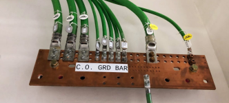

How do I do a grounding electrode in the middle of a concrete dam?
Typically there is a large exposed busbar in the main switching room that is 1/4" X 3" busbar that is the main system ground, you run back to that.
Check the with the plant engineer they should know where the main grounding bus is.
