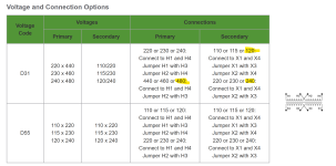

Schneider Electric's tech support is telling me 120V AND 240V is not possible due to the jumper configurations that are required.
In their catalog, this is what they're referring to:
But to the point a few of you have made, if you jumper X2 and X3, this is essentially the same as a single phase 240V panel. Which means I could connect to X1 or X4 and X2/X3 to derive 120V.
Exactly. You connect X1-Hot, X4-Hot, X2/X3-Neutral/Ground, and you get a 120/240V supply.
There is a problem in their table, it does not included any of the load connections, so it is hard to see that a neutral point does exist when X2 is jumpered to X3.
The ANSI voltage connection shown in columns 2 and 3 show single voltage connections as an "X" and multiple voltages as a "/". So their voltage code D31 provides 3-wire outputs, while D55 only provides 2-wire ones.
The industry standard convention is:
An 'X' means either of the single voltages is available based on the winding configuration. In your example 120V or 240V 2 wire
A "/" means either or both of the voltages are available based on the winding configuration. In your example 120V or 240V 2-wire or 120/240V 3-wire.
