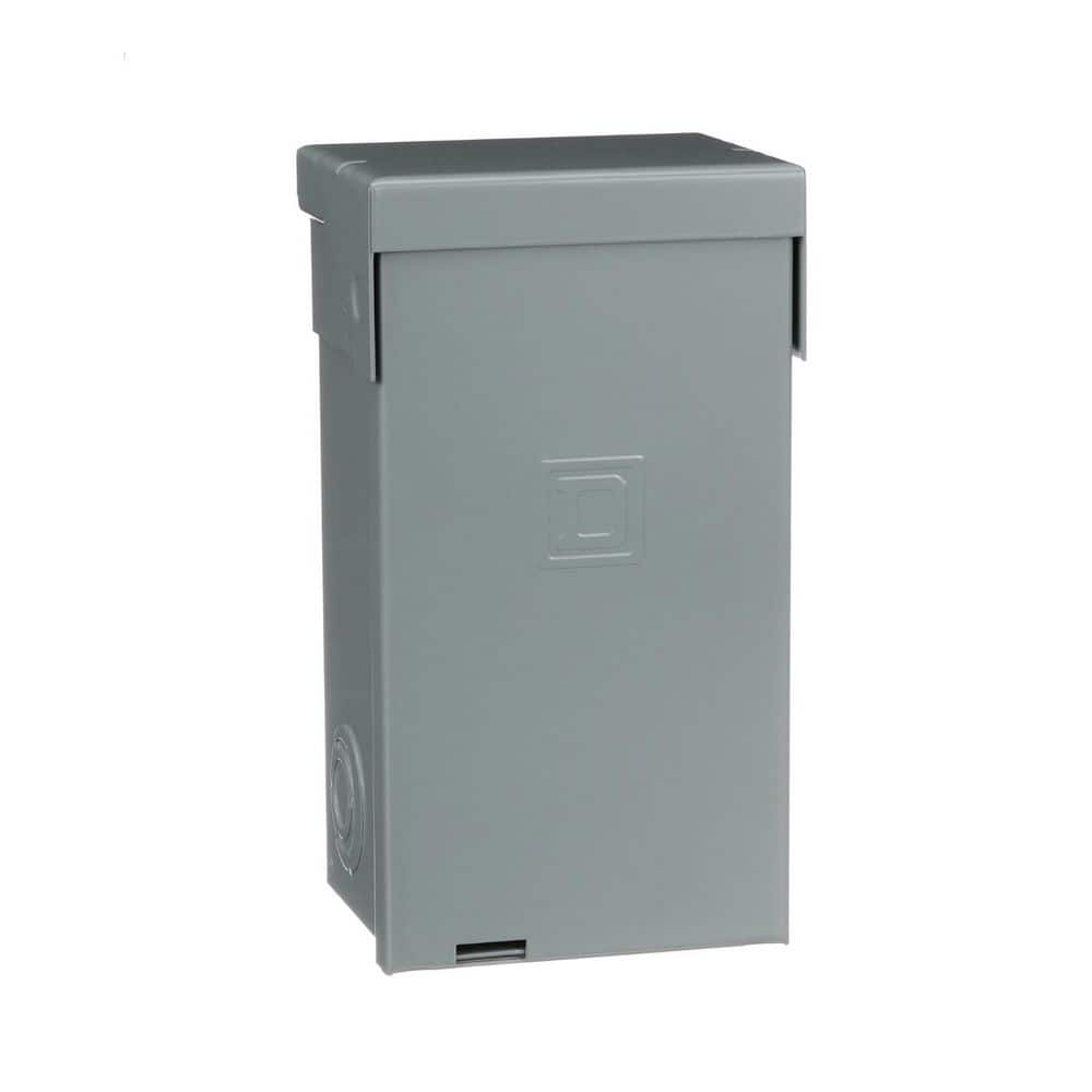

Just to open another can of worms, these are sometimes used and they look suspiciously like circuit breakers, but they're not.
They have no OC protection, and operate only as a two-pole switch.
