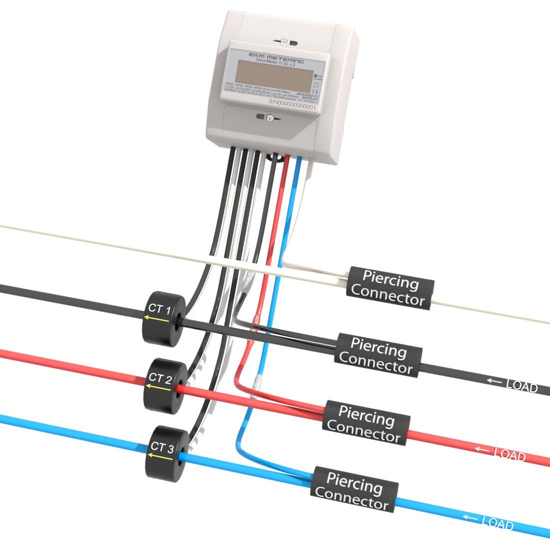

One strategy, which I usually prefer, is to use 220.87 for future additions. Get away from those bloated unrealistic NEC calcs
When you consider that the actual demand will typically be half or less than an NEC load calc, it likely makes a lot more financial sense to install something like an 800A service, and throw a logger on it. Likely if you have that data for your own knowledge and for any permit or plan reviewer, you probably won't need to upgrade any equipment when stuff is added. For example, for well under a grand......compare that to nearly doubling the service size.
I like that idea for this install and future installs. Makes the whole 30-day data logging or 1 year worth of maximum demand fast and easier to acquire. I do a lot of industrial work and have had to use 220.87 more than a few times. Thanks.
