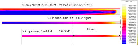

For the best answer for skin and proximity effect -- it is best to model the system with Ansys, Quickfield, Maxwell, or similar finite element analysis (FEA) electric and magnetic field software .
I do a lot of 360 to 800 Hz power distrubution analysis and also need to build custom transformers into the hundreds of kHz ranges.
Once you build a physical model, the FEA programs will spit out the impedances, etc.
Here is an example of skin and proximity effects of a thin foil transformer winding at a few hundred kHz showing that current crowding even goes to teh edges of foil windings.
Have fun!
