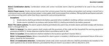

As long as it is not new construction and not commercial, you can use battery only and WITHOUT hardwired interconnect as long as the detectors are listed to be used as such.
Here is what the WAC says about both (see R314.4 & R314.6 W/ exceptions 1 & 2):
