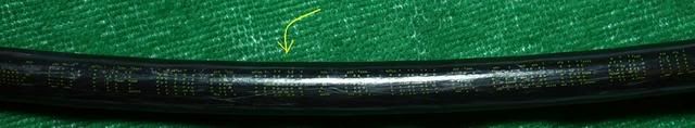

I have a question about this no lube thhn, all the ads and the promo video I've seen show this wire being pulled in underground conduits. Now it seems that it is only listed as thhn and not the standard thhn,thwn,mtw. So wouldn't be against code to install a listed wire for dry and damp locations in a wet location?
