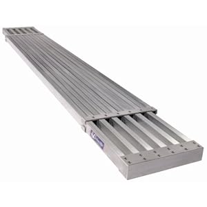

I'm looking for one of those things you put on stairs to make a platform for a step ladder. I have been to the Werner site and our local ladder house site with no luck.
Anyone know what those are called?

Are you looking for something like this, but stationary? Smaller?

I am, I need to be facing the wall, not facing up or down the stairs as I would be on a little giant.

Yes, thanks D. I'm cutting and chipping vertically in many locations so I was looking for a platform that once adjusted to the risers it could be quickly moved up and down the treads. I have seen these before, but for the life of me I can't find one.

You want a platform that will level out a stairway so you can set a ladder on it?
Why not just get a ladder that adjust to the stairs?

An extending plank like painters & drywallers use, streched between a stair/landing and a ladder sounds like a Gee-whiz solution.
Oh, wait. Scratch that. It's aluminum. Better find a nice safe steel Bakers scaffold.

Well Chris we always use a scaffold with adjustable legs adjust for your step to step level planks and put plywood on top nail it .
Two guys can move it up and down .
Put ladder on top with AL :D
Opption 2 = Boatswain chair hung from bar joist if you got them or rigg a steel cable up there and swing al across the wall.
The chairs today are osha safe they come with a seat belt .:D
