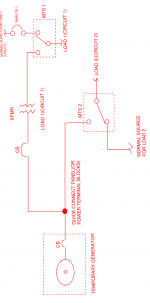

Greetings, All-
I'm designing a setup, where a temporary genset will be supplying two circuits via a Quick Connect panel. I wanted to get feedback if it is kosher to have two circuits supplied from one source. I believe it is permitted to have a single breaker supply two different circuits. The tap rule would not apply here, since both circuit conductors ampacity would be sized to be higher than the GEN breaker. I believe circuit conductors from the Genset to the equipment downstream would be considered feeders here per NEC definition(not that it matters that a whole lot here).
Does any one see holes in this design? Please see the single-line attached.
Thanks for your feedback!
