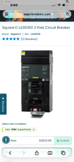

The breaker that you are specifying does have an adjustable magnetic trip, or is the existing too old? so you should be good there.
